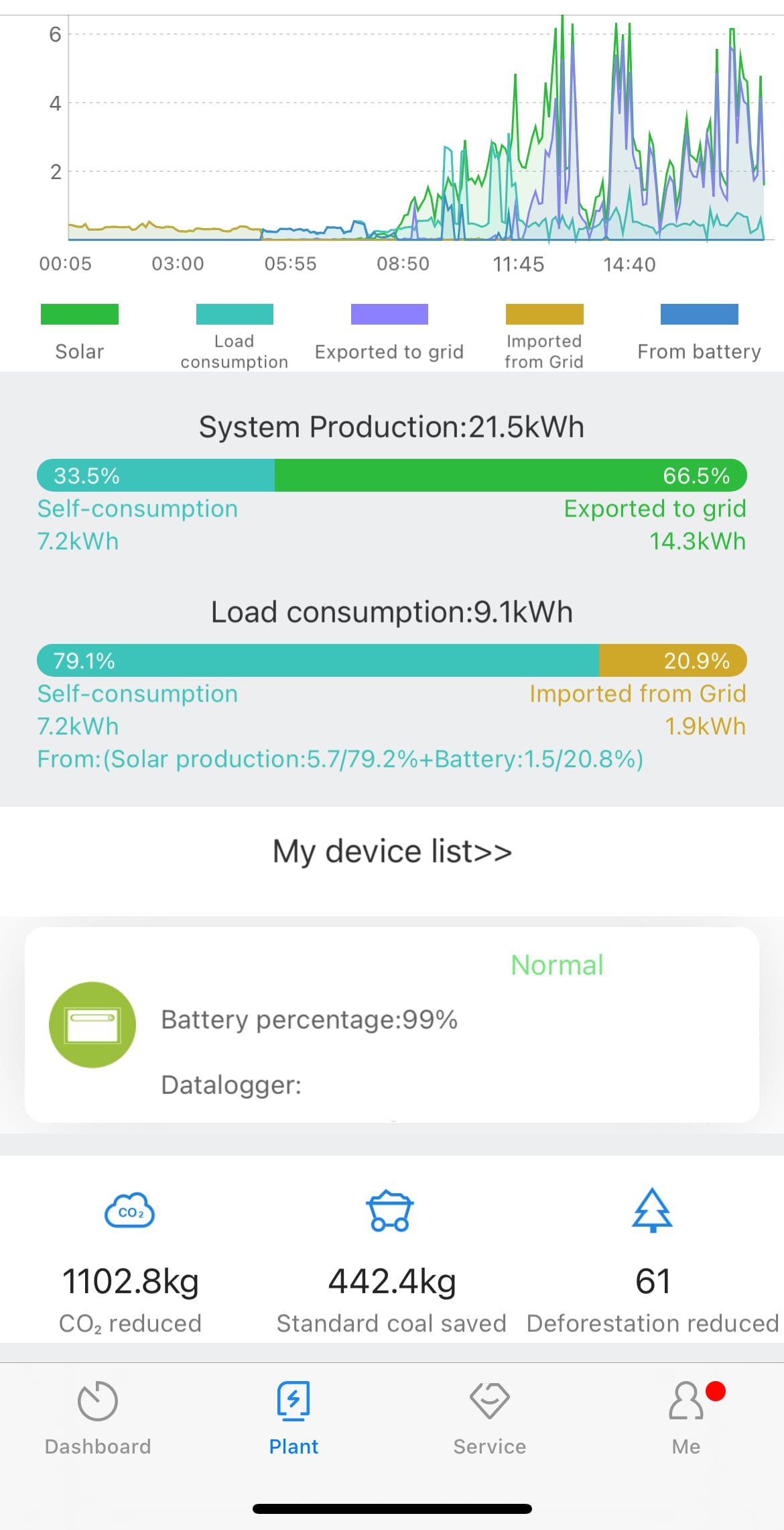

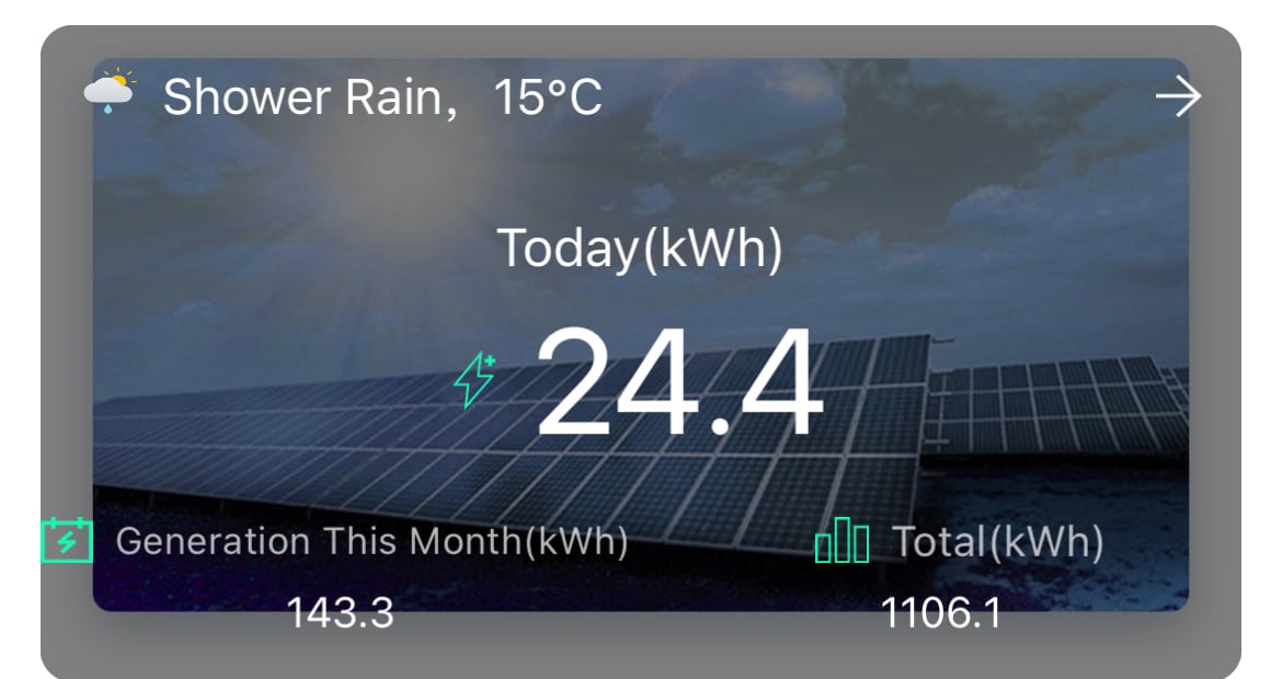

Once we log in, we see the main dashboard, which looks like this:
Make sure you are on the Plant page, as indicated by the navigation bar at the bottom of the app.
Scroll down until you see ‘My device list’, under which you will see your inverter serial number at the battery’s state of charge (SOC).
Click on the inverter anywhere near the inverter icon under the ‘My device list’ section.

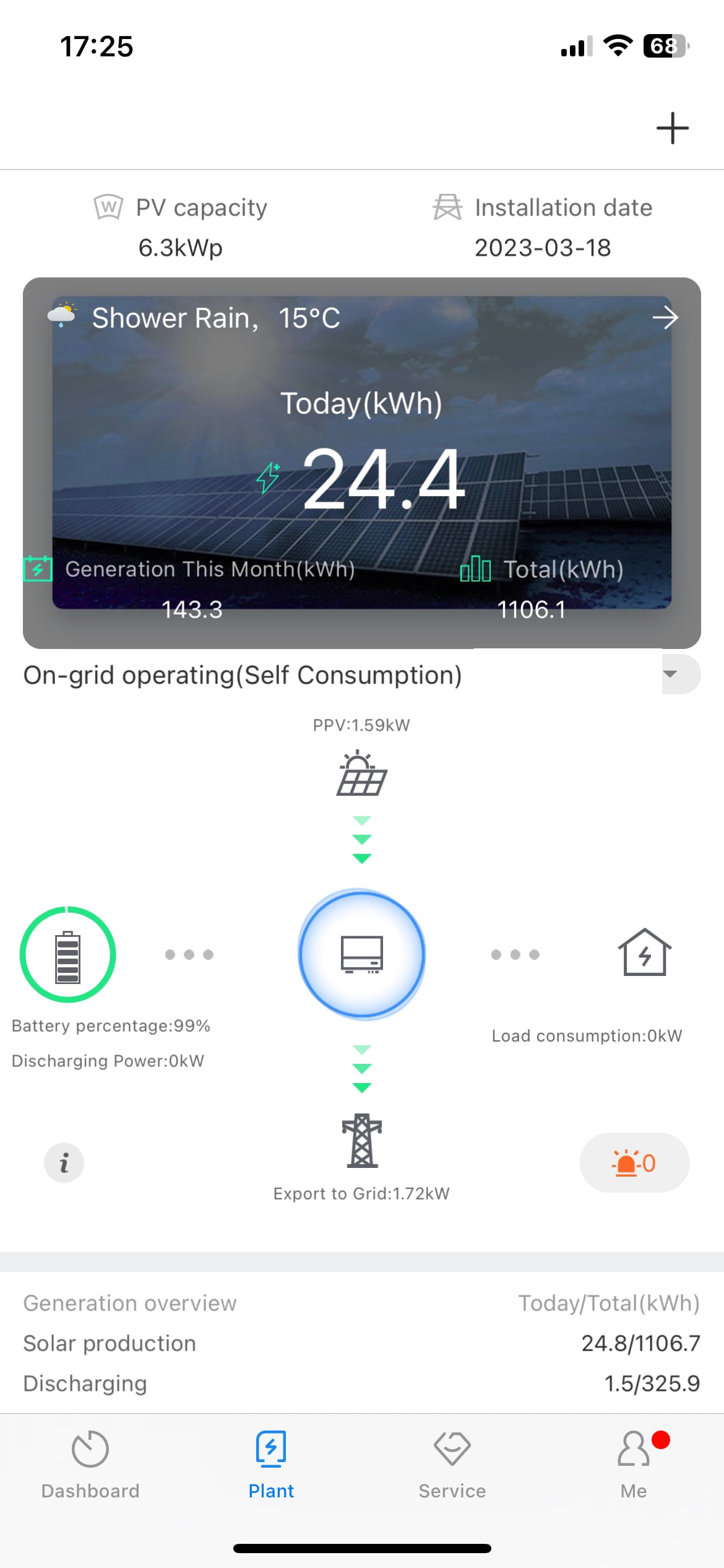

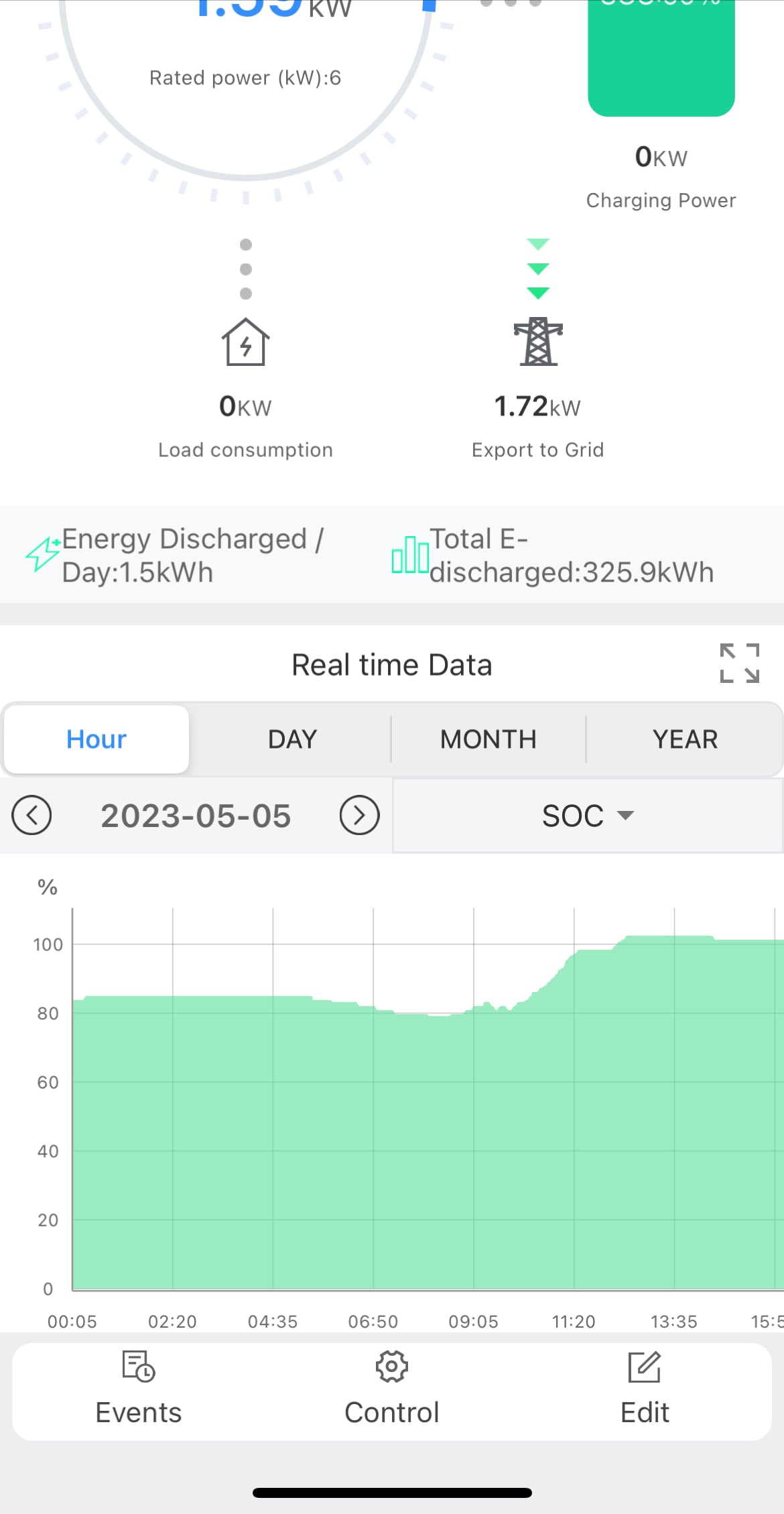

You are now on the inverter page, which should look as follows:
At the bottom you see another navigation bar with three options: Events, Control and Edit. Tap ‘Control’.

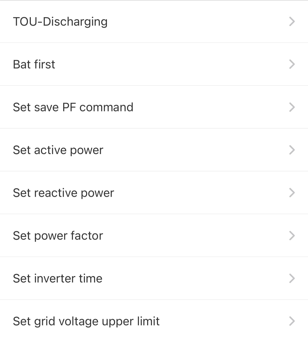

You should now see a list of settings that you can change or set on your inverter.

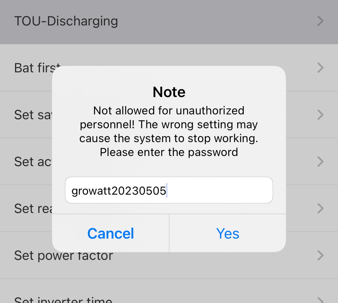

Right at the top, you see TOU-Discharging. That’s what we want to set. It should really be called Export to Grid, that would be clearer.
Tap the TOU-Discharging option, and you will be prompted to enter a password. The password is basically the text growatt, followed by current date in year, month and day order. For instance for May the 5th 2023, the password would be: growatt20230505
Confirm, and you should now see the TOU-Discharging settings.

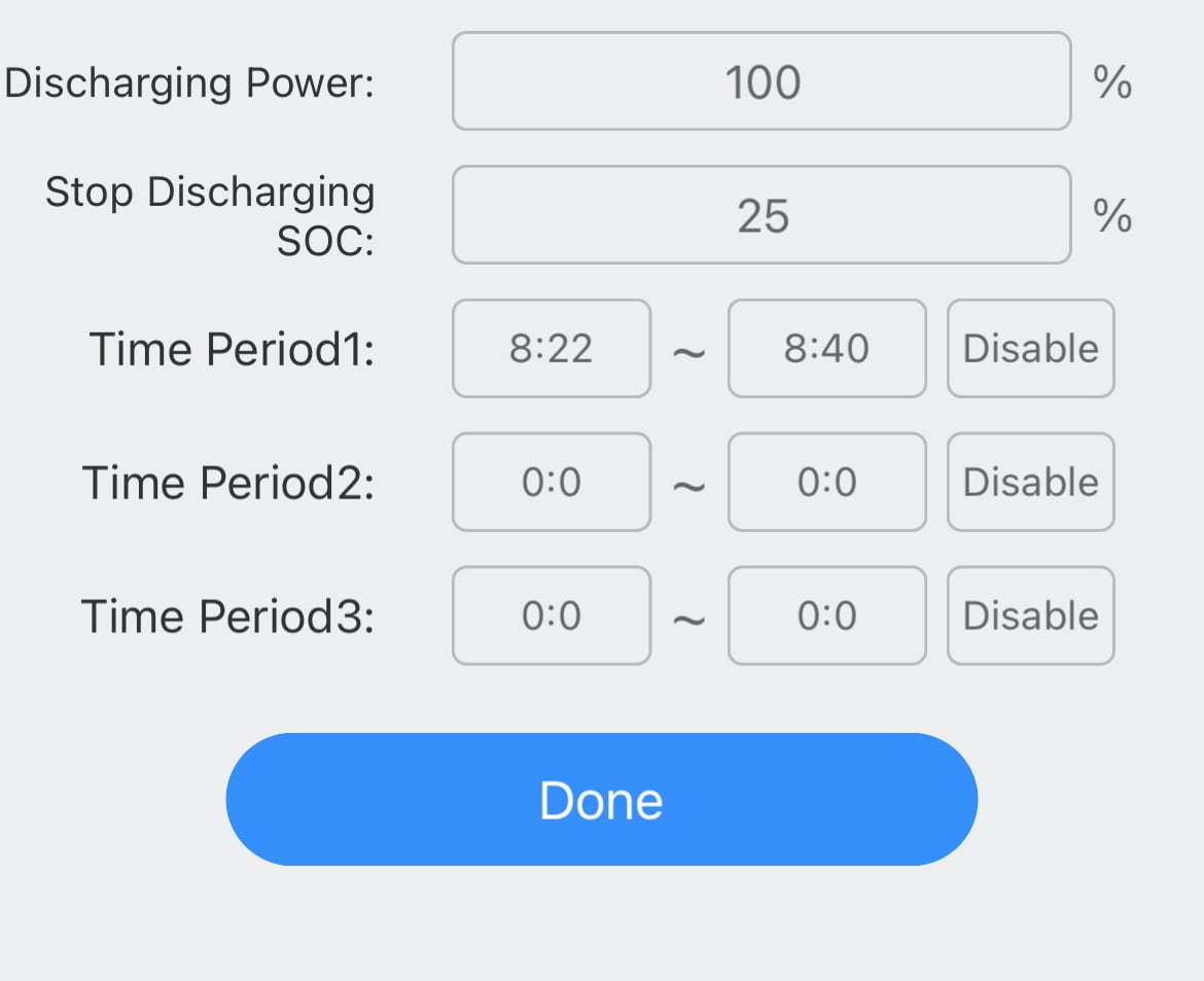

You can see multiple items here.
- Discharging Power: this is the discharge rate of your battery. A value between 1 and 100% which determines the amount of flow. Think of this as a tap, 100% is fully open, 1% would be droplets trickling through.
- Stop Discharging SOC: The battery level percentage at which you would like to stop your battery force discharging to the grid.
- Time Period 1: the From and To times for your feed-in tariff window. If your feed-in tariff is between 16:00 and 19:00, you would specify those here.
- Disable/Enable: A toggle, to enable or disable the specified schedule. Make sure you Enable this prior to clicking Done.
Note that you can specify up to three separate windows for exporting to the grid.

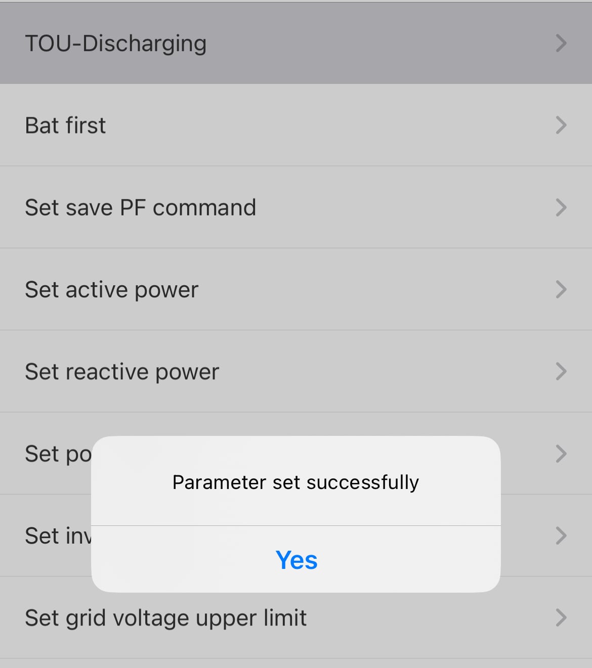

After you specified your interval(s) and clicked Done, you should see a message like this, to indicate the setting was successfully changed.
You are now all set to export from your battery to the grid first and get paid for your feed-in tariff, during the schedule you have set up.

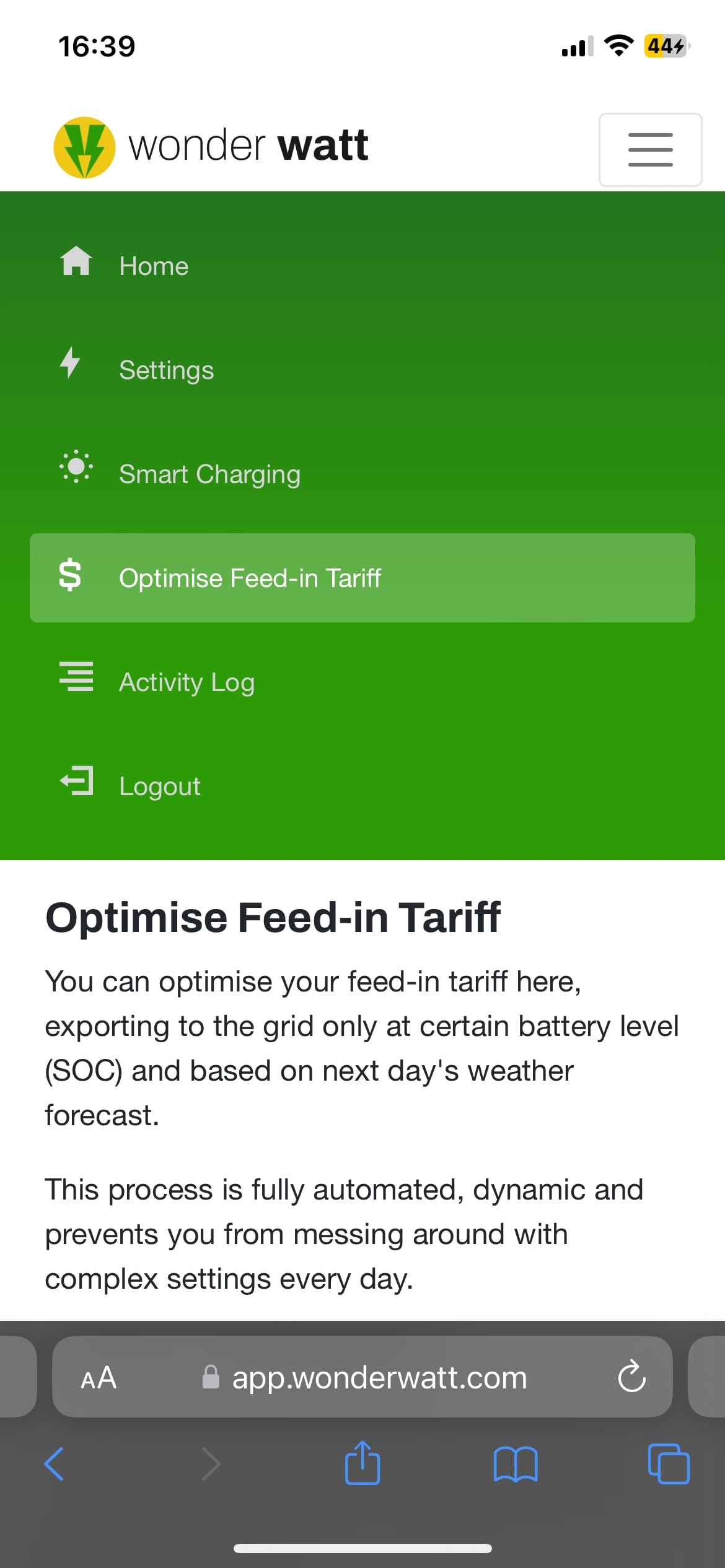

Once you have logged in with a Google account, you can fill in the required Settings from the dashboard menu, under Settings.
When all these settings are saved, you can now move on to the ‘Optimise Feed-in Tariff’ page, which can be accessed via the menu.

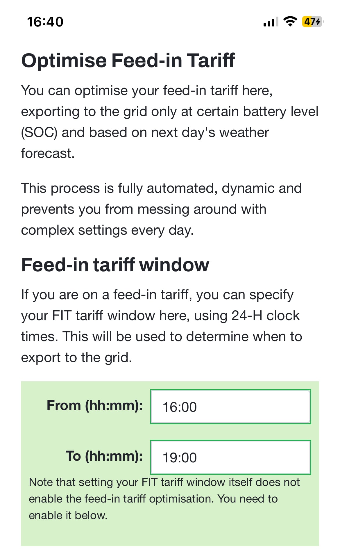

When you navigate to this page, you can see that you can specify your feed-in tariff from and to times.
Note that the time format is 24H and should be for your local time zone.
Continue with setting up the export to grid optimisation by configuring your own values for the following fields, here is an example.
You can see the following settings:
- Export to Grid: When this is enabled / ticked, the battery will force discharge to the grid if the conditions for battery charge and solar forecast are met. Unticking will mean that the export to grid schedule is not active.
- Battery is at least: The state of charge in a percentage, which the battery will have to be at least at, before exporting to the grid.
- Solar forecast is at least: If the solar forecast in kWh for the next day is at least the specified amount, and the battery condition has been met, export to grid will run.
- Stop export at: The battery percentage to stop exporting to the grid at.
The solar forecast will be determined based on your location latitude/longitude provided in Settings, and the configuration of your solar PV system.
Wonder Watt will automatically schedule this every day and run this a few minutes prior to your feed-in tariff window start time.
